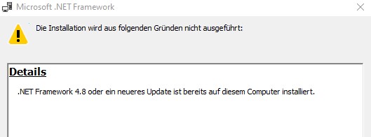

So, it seems, that .NET is already there... wrong version?
- Screenshot 2024-11-09 133111.jpg (15.4 KiB) 2441 mal betrachtet
