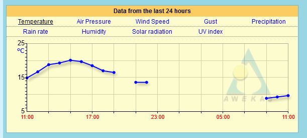

I have Froggit HP1000SE PRO for 2 months now. First month everything worked as planned, but after 1 month I am experiencing data/connectivity loses between data unit and outer sensor unit. You can see random data outages here on graph: https://www.awekas.at/en/instrument.php?id=24401
I have no idea what can cause this problem.
I am thinking about changing the batteries and/or bringing the sensor unit closer to "data unit", but the random pattern of loosing the connection does not indicate that batteries nor distance is a problem.
Help in every direction would be appreciated. Thank you.

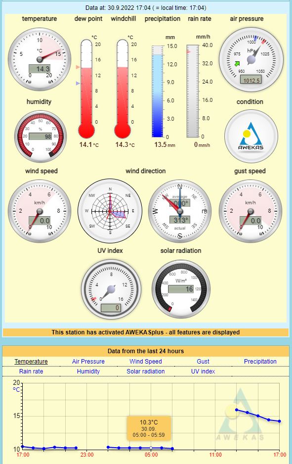

Since it is raining I did nothing to the station until now, however it appeared online again.. mysteriously. :)
online again.JPG (112.57 KiB) 4059 mal betrachtet
I excluded power and WIFI outages, FW version is the last one available (1.8.5.), so the only issue can be between display and unit.

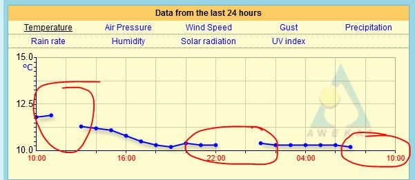

And we have connectivity issues again.
Trying to get a pattern here... I will move sensor array closer to console.
Will report back.
BR Mtt

Answering for the sake of closing this thread. I monitored the disconnection activity for 10 days and started noticing pattern. Connection lost at cca. 3-4 AM and until 11 AM which corresponds with heavy fog appearing in the Fall time. Outer sensor was positioned at the very distance limit, working fine at "ideal" conditions, but not when the fog started interfering.
I moved the outer sensor array to half the distance to display unit and now it works fine without any problems since.
