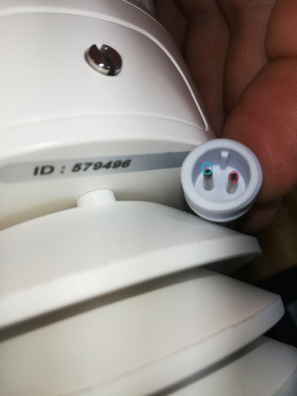

I've already received my Ecowitt WS 90 and would like to know the polarity of the heater connection, see photo below. I made the markings purely randomly, so the plugs would be marked. I already have enough 12V/1A transformers, so I don't need to buy anymore. If no one knows, I'll have to contact Ecowitt. Thanks in advance for the information.

According to this post you're right regarding the polarity.TdB hat geschrieben: 17 Okt 2025, 19:51 would like to know the polarity of the heater connection, see photo below.
